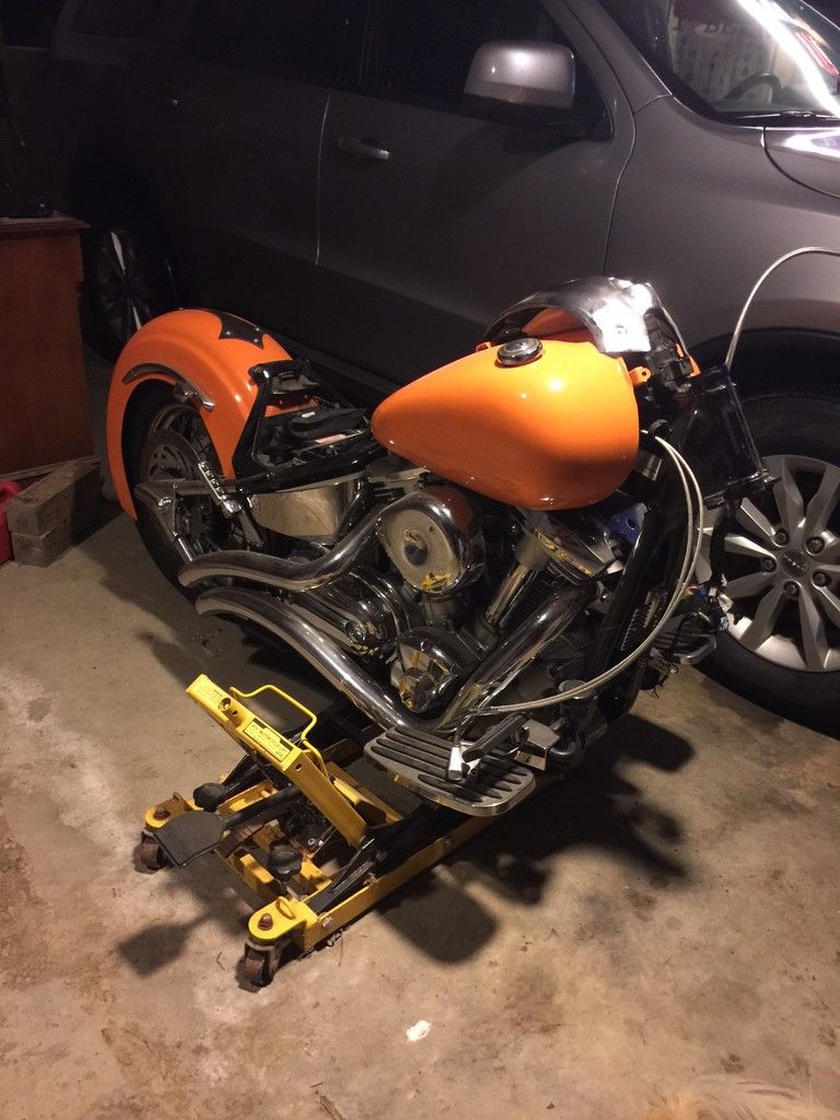

Tear down:

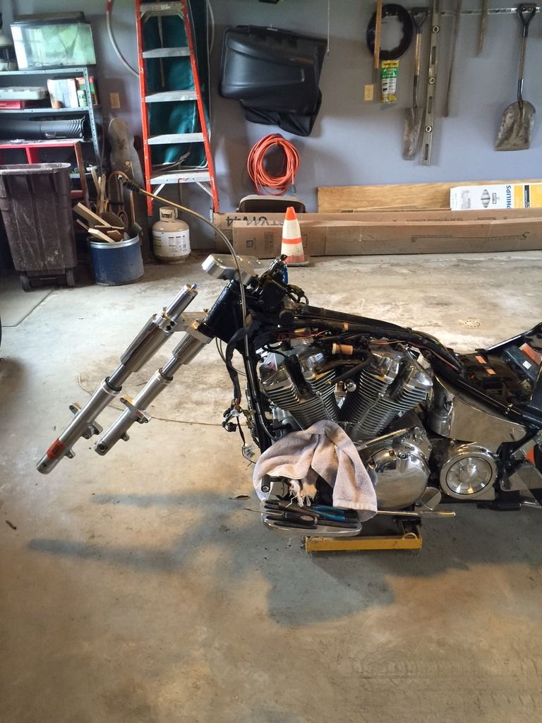

Lose the trees and replace neck bearings:

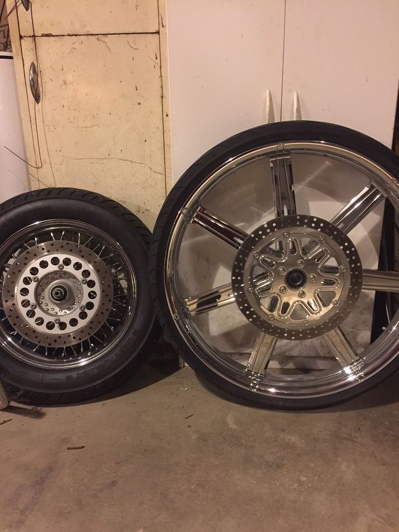

I put a black wheel on my RG and saved the chrome Glenndyne G7 wheel for this build:

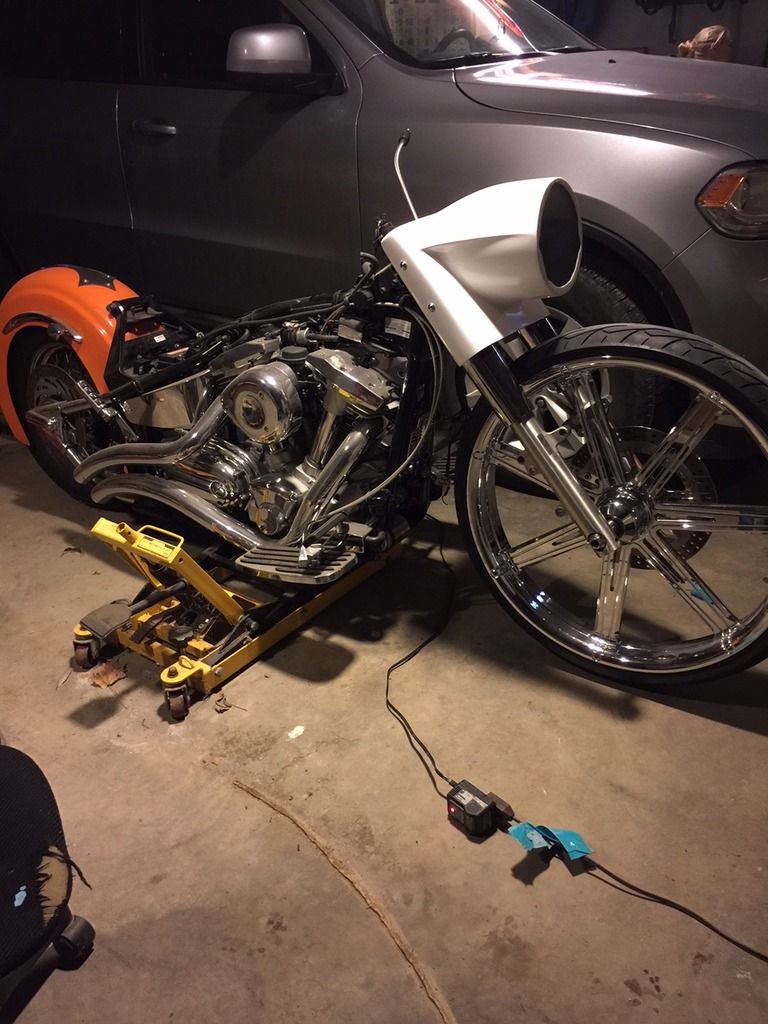

I went with a RK nacelle from BadDad, here is it just thrown on to see how it looks. The bike is still on the lift so it will sit lower when aired out.
Brian also hooked me up with an adapter so I can use an HHI 6 piston caliper. Still need to figure out fender mounts, bars, etc and the front will be pretty much mocked up. Then on to the ass end.

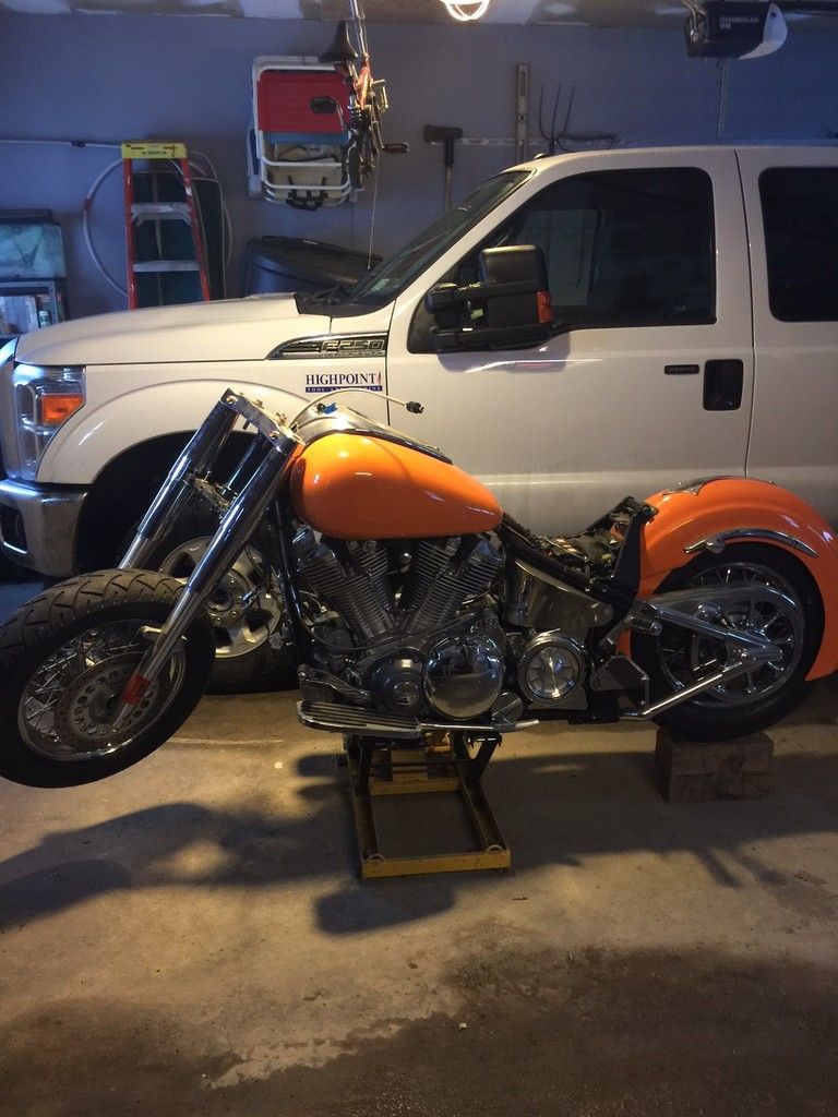

Thanks guys. I got the rear shock installed last night, and got the rear fender supports and adjustable dog bones set just right so the tire won't rub when aired out. Looks like it will sit about 2" off the ground. I can't get it off the lift until I get the air plumbed/wired.
